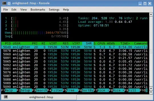

or [htop] command,
htop result
Source: BinaryTides
