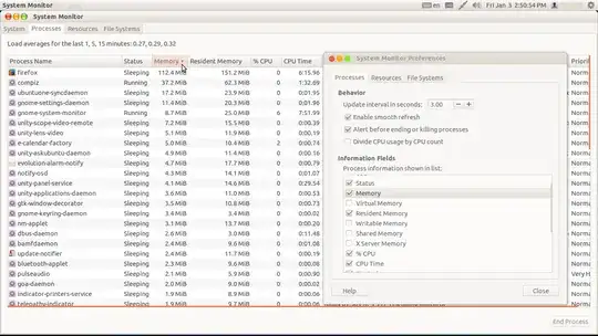

Use system monitor to see which process is devouring all your memory to get a possible idea of what you should do next.
snap1

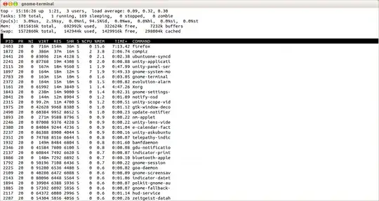

You can do the same with top; use Shift + < / > key combos to select the memory usage column, and Shift + R to toggle the reverse-state of column sort.
snap2
You can then kill the process that's causing the problem.
