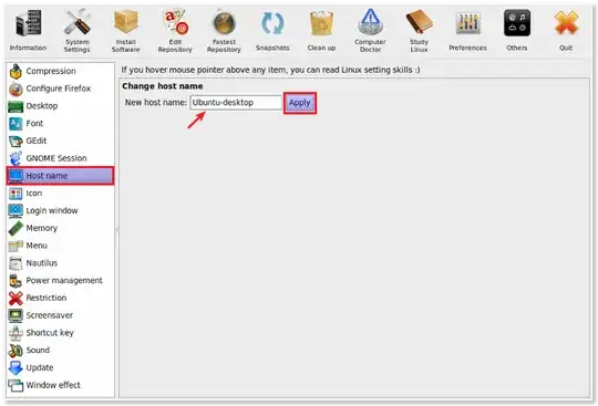

Another better and safe way to rename hostname
Install ailurus
  • Add the PPA and update your repository
    sudo add-apt-repository ppa:ailurus && sudo apt-get update
  • Install ailurus
    sudo apt-get install ailurus
  • After installation it will be found under Applications>>System Tools>>Ailurus
    alt text
karthick87
  • 84,513
