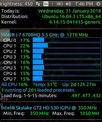

Even when set to powersave instead of performance you can see by running top or in my case conky the CPUs max out at top turbo speed:
The display starts out for a few seconds running around 1100 MHz at 50 degrees Celsius watching a Dr. Who Video on one screen and four Firefox tabs open on the other screen.
Then the stress test engages and temperatures spike to 80 degrees Celsius with all four cores (8 virtual CPUs) running at 3100 MHz. From Intel's wikipage for the i7 6700HQ:
