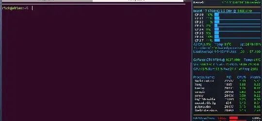

The following commands are used in the .gif below:
time sudo updatedb # See 8 CPUs run at 3.5 GHz. Then set 800 MHz Below
echo 800000 | sudo tee /sys/devices/system/cpu/cpu*/cpufreq/scaling_max_freq
time sudo updatedb # See 8 CPUs run at 800 Mhz. Then set 3.5 GHz Below
echo 3500000 | sudo tee /sys/devices/system/cpu/cpu*/cpufreq/scaling_max_freq
time sudo updatedb # Time is 3.5 seconds instead of 13.8 seconds
