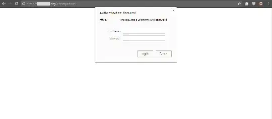

5. Protect PhpMyAdmin URI path via Password authentication
More details could be found in this Apache's manual: Authentication and Authorization. The package apache2-utils must be installed. In short the steps are:
  • Create folder outside of /var/www, where the password file will be kept. Then generate password file. Let's assume the name of this new folder is /var/www-auth:
    $ sudo mkdir /var/www-auth
    $ cd /var/www-auth
    $ sudo htpasswd -c .htpasswd.phpmyadmin <user>
    New Password: *********
    Re-Type New Password: *********
    Adding Password For User <user>
    • .htpasswd.phpmyadmin is the name of the file in which the password will be stored.
    • user is the login name that will be used.
    • ********* is the password :)
    • -c means create new file. If this option is omitted htpasswd command will try to add the new login name to an existing .htpasswd.file.
  • Modify PhpMyAdmin authentication type, through edit /etc/phpmyadmin/apache.conf in this way (or create .htaccess file):
    <Directory /usr/share/phpmyadmin>
        <IfModule mod_authz_core.c>
            <IfModule mod_authn_file.c>
                AuthType Basic
                AuthName "The name of the authentication form - type some user and password hints"
                AuthUserFile /var/www-auth/.htpasswd.phpmyadmin
            </IfModule>
            Require valid-user
        </IfModule>
    </Directory>
  • Enable the modules and restart Apache2 to apply the new configuration:
    sudo a2enmod authz_core authz_user authn_file
    sudo systemctl restart apache2.service
  • Now to access PhpMyAdmin's URI you must provide the login name user and its password.
