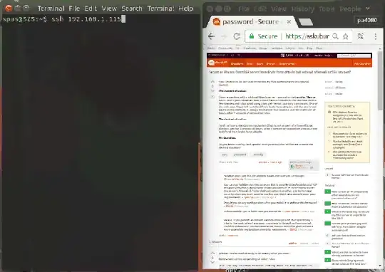

5. Example of usage
In this example is used the Authenticator extension for Chromium/Chrome:
