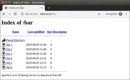

There are several things that could be changed in your configuration. In order to help you, I'm providing here the following guide, based on the default Apache2's configuration.
Deal with the file system permissions
In order to access the files, the Apache's user www-data needs to have read permissions to the files and read-execute permissions to the directories, also in this number read-execute permissions to the whole path. If you do not have any special requirements, I would suggest you to use the other users permissions.
Let's assume the directory you want to index via the web server is named bar and it is located in the home directory of the user foo. By default he directories /home and /home/foo must have 755 permissions. The last bit in the octal number 755 means all other users have read-execute permissions (content rad access) to the files inside /home/foo.
So let's create our directory /home/foo/bar and let's assure it (and its path) has r-x permissions for the other users:
mkdir -p /home/foo/bar                            # create the directory
find /home/foo/bar -type d -exec chmod o+rx {} +  # apply o+rx for the dirs recursively
sudo chmod o+rx /home /home/foo                   # this step is optional
Now let's create three test files and assure they have read permissions for the other users:
touch /home/foo/bar/file.{1..3}                  # create three empty test files
find /home/foo/bar -type f -exec chmod o+r {} +  # apply o+r for the files recursively
In order to allow www-data to write content in /home/foo/bar you can change the group ownership of the directory and add rwxs group permissions (more details):
find /home/foo/bar -type d -exec chgrp www-data {} +
find /home/foo/bar -type d -exec chmod g+rwxs {} +
Test by creating another three empty files:
sudo -u www-data touch /home/foo/bar/file.{4..6}
Deal with the Apache's configuration
By default, within the main configuration file /etc/apache2/apache2.conf, for security reasons, the access to the root directory / is restricted. I would suggest you to do not override these rules via the virtual host configuration and remove <Directory /> tags (and the enclosed directives).
In particular, if you are creating an Alias to a directory outside of your DocumentRoot, you may need to explicitly permit access to the target directory (source Apache Module mod_alias).
Let's first create .htpasswd file with enough permissions (add more security by using 2FA - p.6):
htpasswd -c /home/foo/.htpasswd foo               # authentication for the username 'foo'
chmod 400 /home/foo/.htpasswd                     # restricted the permissions
sudo chown www-data:www-data /home/foo/.htpasswd  # change the ownership
According to the above, the relevant part of you virtual host configuration file should be something like this:
<VirtualHost *:80>
    # Other configuration directives
    Alias "/bar" "/home/foo/bar"
    <Directory "/home/foo/bar">
            #Require all granted
            Options +Indexes +MultiViews +FollowSymLinks
            IndexOptions +FancyIndexing
            # Allow using of a .htaccess files
            AllowOverride All
            # This section could be moved in .htaccess file
            <IfModule mod_authz_core.c>
                <IfModule mod_authn_file.c>
                    AuthType Basic
                    AuthName "Type some hints here..."
                    AuthUserFile /home/foo/.htpasswd
                </IfModule>
                Require valid-user
            </IfModule>
    </Directory>
</VirtualHost>
Enable the relevant modules and restart Apache2 to apply the new configuration:
sudo a2enmod authz_core authz_user authn_file
sudo systemctl restart apache2.service
Sample result
