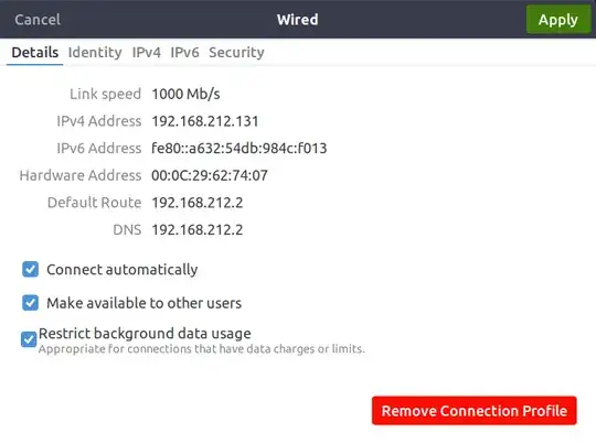

Disable automatic updating if the network connection is metered.
First, go to your network settings.
Network settings
Then, click on the cog wheels on the right side of both of your network interfaces and tick "restrict background data usage" - this marks the connection as being metered.
Restrict background data
Finally, open a terminal and type (docs):
sudo snap set system refresh.metered=hold
