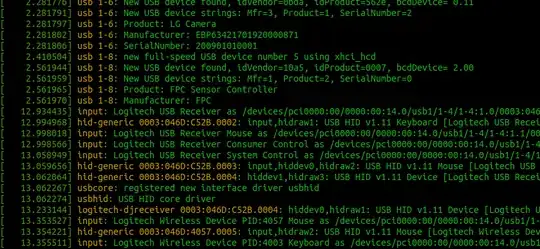

I have a notebook LG Gram 14z980 with Windows 10 by default. I installed Ubuntu 20.04 with dual boot and I notice that the boot time in Windows were much faster than Ubuntu (about 10 seconds). Then, I investigated dmesg and guess what... Ubuntu freezes exactly 10 seconds doing "nothing", then continues booting normally.
Example of dmesg:
[    2.561970] usb 1-8: Manufacturer: FPC
[   12.934435] input: Logitech USB Receiver as /devices/pci0000:00/0000:00:14.0/usb1/1-4/1-4:1.0/0003:046D:C52B.0002/input/input6
I recently upgraded it with an additional SSD NVme (Crucial P5) and 16 GB RAM (Kingston Fury) and the behavior keeps the same, even with a fresh Ubuntu installation.
Does anyone have an advice on how to fix this? w I tried the following commands and I realized that the NetworkManager-wait-online.service was taking 6.237 seconds during boot. Then I disabled it, but dmesg keeps showing 10 seconds freezing as I posted.

None of them seems to take 10 seconds.
