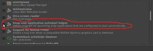

  1. You can disable autostart for the service by clicking on the start button then search for "Startup Applications" and change the setting like this.
