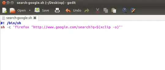

  2. Then you can create a script with the command, create a "new document" and named as "search-google.sh"
  3. Open the file with gedit and put these lines: enter image description here
  4. Save the file in your home eg: /home/user/search-google.sh

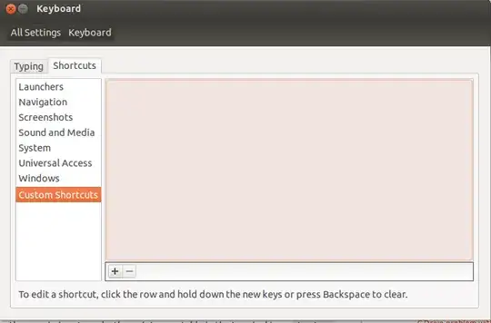

  6. Then you can create a custom keyboard shortcut to execute the script.

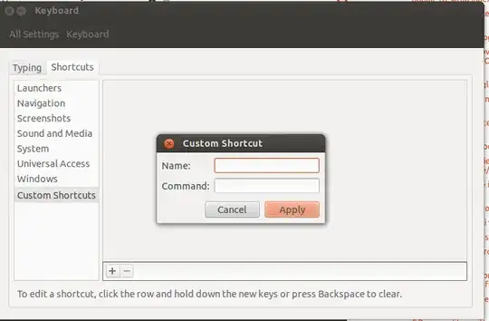

  7. Go to System Settings > Keyboard > shortcuts > Custom Shorcuts enter image description here
  8. Add a new item and fill the fields Name:search-google and Command:sh/home/user/google-search.sh enter image description here

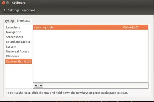

  9. Then give a keyboard shorcut to the script...click in "Disabled" and press the keys to the shortcut. eg: Ctrl+Alt+G enter image description here
  10. So, if you are in a web page or any document and you select or (text highlighted) a word or phrase... then press the keys for the shortcut eg: Ctrl+Alt+G and Firefox will open searching in google for the text you have highlighted o selected.
