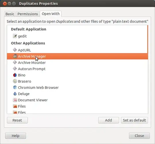

There's yet another GUI solution, which might come handy for you ;)
Try opening the properties (right click -> Properties) of the file type you want to be always played by VLC.
Choose the Open with tab and either choose from a list or add one (by choosing from an extended program list or simply typing vlc as the command)
EDIT:
... and click on Set as default

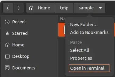

  1. Open a terminal:
    • A) Open a terminal (Ctrl+Alt+t) and navigate to the directory where you have a file you are interested in changing the default application for.
    or
    • B) With the directory open in Nautilus click on the "down arrow" of the folder name and select the option Open in Terminal. A terminal window will appear already in that directory as base.
      Nautilius:Open Folder in Terminal

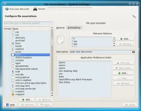

For Dolphin (KDE), right click the file to get a Properties window. Under Type is a button for File Type Options, where you can modify filename extensions. Add the application if it's not in the bottom list. To make it default, move the application you want to the top of the Application Preference Order list.
Screenshot from a more detailed guide:

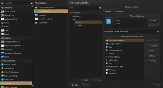

For KDE Plasma users (e.g. KUbuntu), open settings -> Personalization -> Applications -> File Associations. Then enter the relevant file type in the search bar and select the type under Known Types. Then add/move your desired default application to the top of the preference order.
screenshot
