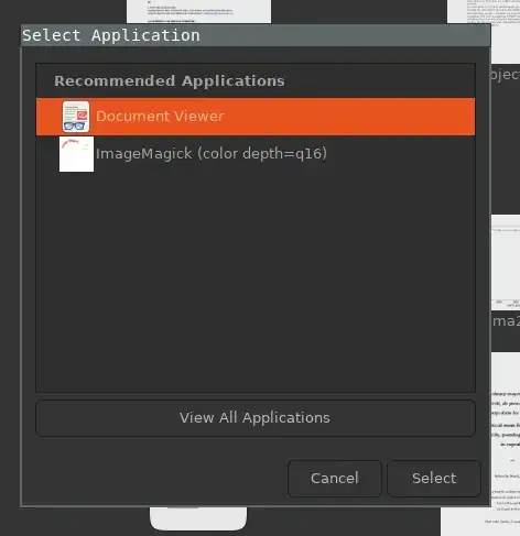

Edit: there's not tick to do when opening a pdf file, so I have no way to chose a default app from there
no tick
