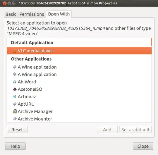

To do it GUI like:
Rightclick any video file, choose properties. Choose Open With and there you can select VLC and the option set as default (bottom right).
This requires you to do that for every video type (mp4, mpg , mpeg, mov ....)...

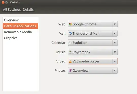

Another perfect method is to use the option in Default applications.
go to "System Settings" "Details" "Default Applications"
CLick on the "down arrow" for "Video"
Select "VLC Media Player"
Then close window.

If you are running standard ubuntu the easiest way to set some default application is through settings. system settings -> Details -> Default Applications (menu on the left hand side)
The easiest way to find settings is to type in dash

  1. Right click on your video
  2. Go to properties
  3. Select open with
  4. Select your prefered application
  5. Click Set as default button

Right click the file in Nautilus, select properties from the context menu, click on the Open With tab at the top, and choose the application you desire. You are done.
