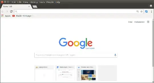

6. Open DVWA and continue with its setup
Open your browser and type: http://localhost/DVWA/. Initially you should use user: admin and passwd: admin, but next you should use user: admin and passwd: password.
enter image description here That's it.
