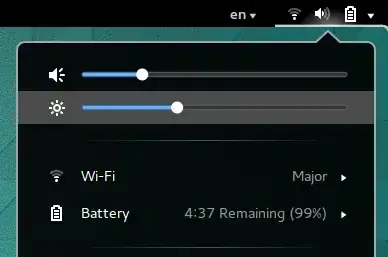

where in this example the number 53 represents the brightness level (range 0 to 100). But I don't know how to link the command to my brightness keys on my keyboard or add laptop like slider next to volume control in Gnome-panel

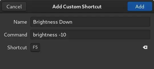

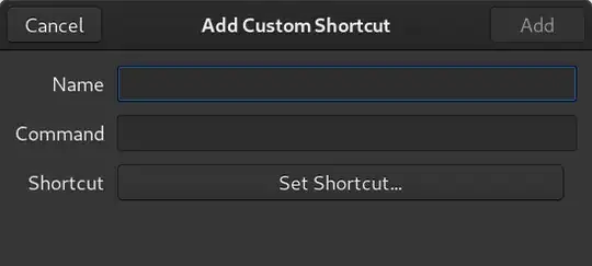

  1. Go to Settings → Keyboard → Shortcuts and scroll to the bottom of the list.
  2. You'll find a + button. Click it to open the Add Custom Shortcut dialog: Add Custom Shortcut
    1. For the Name put "Brightness Up", for the Command, type brightness +10
    2. Click the "Set Shortcut" button and hit the key you want to turn the screen brighter.
  3. Now do the same for "Brightness Down", using brightness -10. Add shortcut
