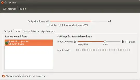

I have problem with my HDA Intel PCH audio under Ubuntu 16.04. I never had any problem with speakers, however my microphone is not working.
When I plug microphone in jack, system reacts and it looks like microphone is in, however no single bar appear in any settings in "Input levels". The microphone works fine, just tested on notebook with Ubuntu 12.04.
Screenshot

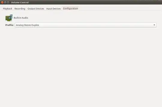

I had this exact problem. My solution:
1) open PulseAudio control
2)go to the configuration tab.
3)select analog stereo duplex to use the computers built in audio&mic

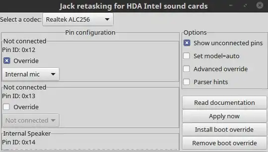

Maybe this will work. Please reply to see if this is specific to that laptop or not.
https://askubuntu.com/a/824806/47206
https://unix.stackexchange.com/a/358989/32012
sudo apt-get install alsa-tools-gui
Then launch
hdajackretask
Then:
Check 'Show unconnected pins'
Check override pin 0x12 to internal mic.
Apply and test. Be sure that the mic level is high enough in sound settings (pavucontrol, etc)
If it worked 'Install boot override'.

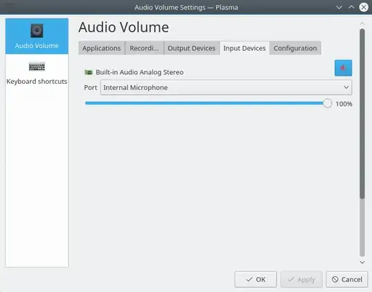

tl;dr : press red volume icon as shown in screenshot image above.
I had the same problem. On Ubuntu 16.04.3 LTS, KDE
My solution:
1) Go to "Audio Volume Settings"
2) Select "Input Devices" (Tab)
** in the top right corner the sound icon is marked in red. As mute.
3) Press (left click) the red sound Icon (mentioned above)
4) Press OK
Check if problem is solved.
If not make sure to choose the right option from the port options in the Input Devices Tab (I choose Internal Microphone) and make sure the volume percentage is above 0%, preferably for the test set to 100%.
It was the internal microphone on my laptop. Meaning the built-in mic in my laptop.

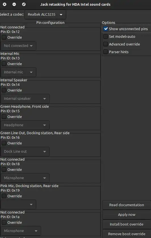

Context: My headset audio was fine and the internal mic was also working. The only problem was with the headset microphone. It was not detecting. After the following steps, it worked again.
Few steps I tried:
  1. Open the HDAJackRetask application. You need to install it if you have not.
  2. Choose different codecs and choose Show unconnected pins.
  1. In pin ID: 0x18, click override, and select Headphone from the dropdown.
  2. Click Apply now and Install boot override.
  3. Hit sudo also force-reload in the terminal.
  4. Restart your PC.
  5. Now again open the HDAJackRetask application and toggle the override option for pin ID: 0x18 to off.
  6. Click Apply now and Install boot override. It worked after this step. If not, try restarting the computer.
I cannot assure it will work for everyone though. :)
