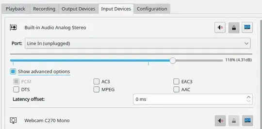

2. Changed my sound card profile from Analogue Stereo Output to Analogue Stereo Duplex
Check here for an image (I don't have enough reputation)
I also disabled my HDMI sound (top device in picture), though I don't believe this had any effect

I did those steps, but under Input Device I still have a Line In (unplugged) while under Output Device it recognize my headset is plugged in.
