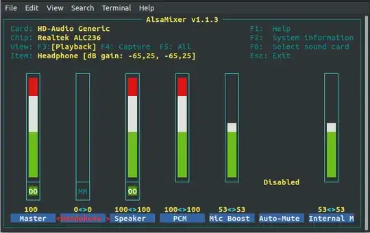

  2. I installed alsa and change the parameters with alsamixer but the Internal Mic Boost is always zero, I upload it but the changes are not saved after rebooting.
    screenshot of AlsaMixer

Are you sure that you're configuring your microphone using alsamixer correctly? I noticed the screenshot you attached of alsamixer is on the [Playback]/Output view and not on the [Capture]/Input view. Press F4 to switch to the [Capture]/Input view and configure there.
