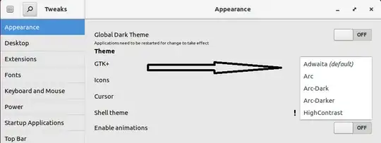

The suggestion here is to use themes that are best suited for the desktop-environment that you are running.
The default theme for Unity called Ambiance is the theme you should use for Unity itself.
When switching to GNOME-Shell, the default theme you should use is Adwaita.
Third-party themes can also be used - their support for various desktop-environments can vary. Examples that you can use in both include Adapta and Arc-Theme (available in the 16.10/17.04 repo).
Its also worth double-checking that you have not got locally installed themes in ~/.themes - themes are GTK+ specific so if your theme is not compatible with the version of GTK+ you are running on, then odd stuff like you described can occur.
GNOME-Tweak-Tool (available from GNOME-Software) can be used to switch themes in GNOME-Shell; unity-tweak-tool can be used in Unity if you are using third-party themes.
How to install themes with GNOME tweak tool?
