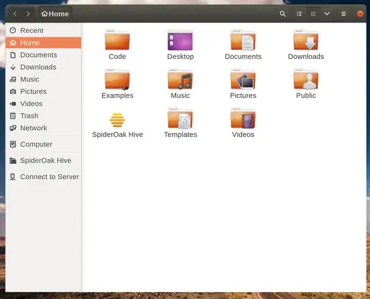

Here's a screenshot of the issue, as you can see there is no window border.
missing window decorations in gnome3 on ubuntu 16.04

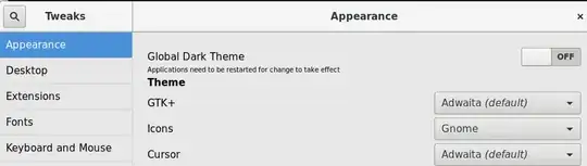

Install gnome-tweak-tool
sudo apt install gnome-tweak-tool
In the appearance section, reset GTK+, Icons, Cursor
