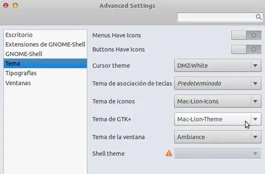

  5. Enter gnome-tweak-tool
Finally will appears the tweak window (similar as the following) and you'll see the themes that you've previously copy in the themes folder and will be able to choice them!
screenshoot

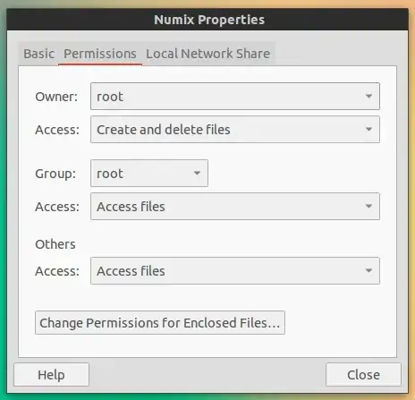

I had the same problem when placing themes in /usr/share/themes. You need to make sure the permissions are set correctly.
Right click on the folder of your theme and select properties, go to the permissions tab and set it like this:
Image of Permissions
Now go back to gnome tweak tool and your theme should be there. Alternatively, you could create ~/.theme and put your theme in there.
