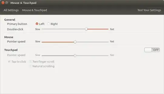

For Ubuntu before 17.10 (Unity)
Open System Settings -> Mouse & Touchpad : in the Touchpad section switch from ON to OFF
Additional information for other users reading this post: The answer was written before the content of the question was changed, originally the question was: "An actual solution to disable touchpad? I just want to disable the touchpad completely, no scrolling, no moving the cursor, nothing.". So the answer from @Pilot6 is the much better solution for what the current version of the question is asking about!

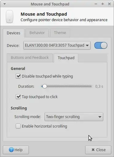

I don't know exactly when this feature was introduced, but in Ubuntu 20.20 LTS it's very simple.
In the search bar, search Mouse and Touchpad. Then select the Touchpad tab and check Disable touchpad while typing.
Mouse and Touchpad Ubuntu
That's all!
If you are quick or slow in typing you can also customize the Duration. That is how much seconds the trackpad will be disabled when you press a key. Set it lower if you are quick, upper if you are slow.
If you have not that option, try other answers.
