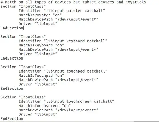

I tried opening the file /usr/share/X11/xorg.conf.d/90-libinput.conf put I think it's messed up or something, I'm not sure.
It looks like this

Edit the /usr/share/X11/xorg.conf.d/90-libinput.conf
And add to the touchpad section after Driver "libinput"
Option "Tapping" "True"
Option "NaturalScrolling" "True"
Then log off and on. This will enable tapping and reverse scrolling.
