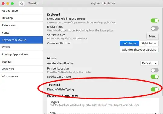

Install gnome-tweaks
sudo apt install gnome-tweaks
and open it.
Under the tab Keyboard & Mouse you will find in the main window under Touchpad the switch Disable While Typing.

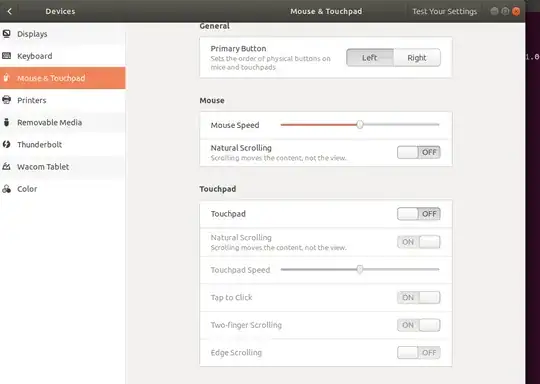

No extra package required to disable, do below
  1. Go to settings
  2. Devices
  3. Mouse & Touchpad
  4. In Touchpad toggle the button to off, see below picture enter image description here
