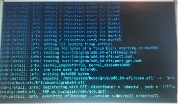

here the grub-install freezes
So the problem is when efibootmgr tries to register the new entry in the UEFI. I also confirmed it by running this:
_sudo efibootmgr -c -d /dev/sda -p 1 -w -L ubuntu_
after which it again hangs.
