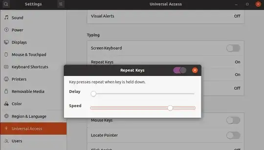

These settings are under Settings → Universal Access → Typing → Repeat Keys. You have to click the Repeat Keys row item, which brings up a pop-up dialog with two settings: Delay and Speed.
This works in Ubuntu 17.04 and above.
In older versions of Ubuntu, the Speed setting worked in reverse: the lower the speed, the faster the repeat rate. This is no longer the case.
