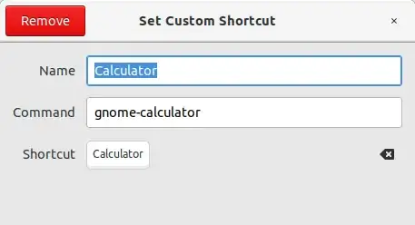

You can remove the default shortcut for "Launch Calculator"...
Remove default Calculator shortcut
and instead add a custom shortcut to run gnome-calculator, and assign the Calculator key to it:
Custom Calculator shortcut
