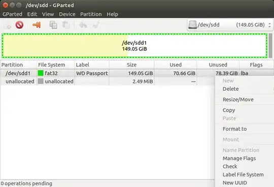

Step 4: Copy partition
Select the partition you just shrunk and from the menu select copy.
Select the external hard drive and paste the partition there. It is best if the external hard drive does not have any partitions and or data.

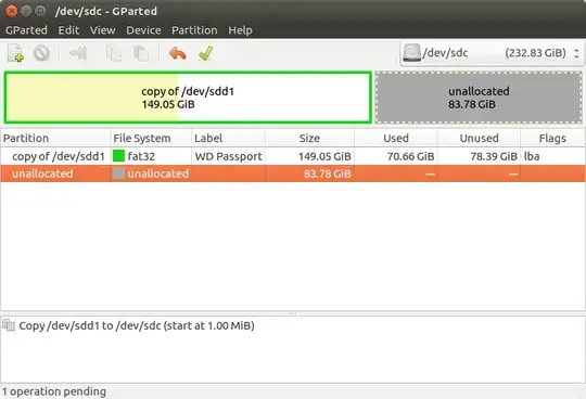

Step 7: Copy from the external hard drive to SSD
Select the partition in the external hard drive and from the menu select copy.

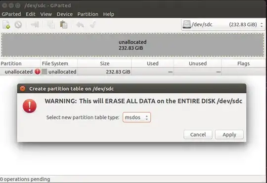

Assuming it is a new SSD, you may need to create the MBR (msdos) in it before you can paste the partition.
Select the SSD and paste the partition there.
Apply to actually do the work. Until you press Apply it will look something like this:
