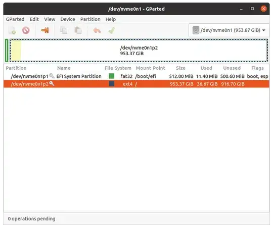

2- What is the partition structure of the source drive?: I have downloaded GParted and I shared the structure below. But found out that there are different numbers compared to Disk Usage Analyzer. Here are both reports:
Gparted:

  2. What is the partition structure of the source drive, or if you want to clone only one partition. From the way you wrote the OP, I guess you want to clone only one partition of 1Tb, and that your partition has the OS, otherwise you could simply rsync the contents. Then you have to check if you have root and home in separate partitions.
Lacking this information, I would say that if option 1 satisfies your technical requirements, it should work pretty straightforwardly, and I would stick to it. Alternatively, you could clone directly into your target destination if not the pendrive.
