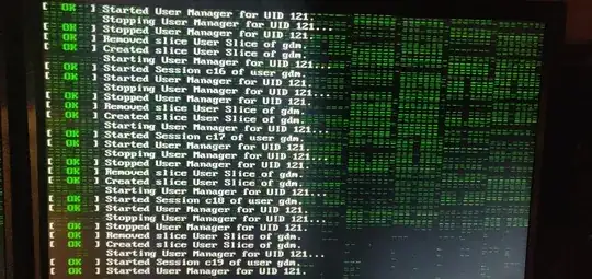

However, after resizing and copying, nor my original HDD or my new SSD boots up. The original HDD does show the purple Ubuntu loading image, but gives some strange text afterwards (See picture below). The SSD does not boot at all (But I also didn't try to re-install GRUB here).

Managed to solve the issue!
Step 1: Boot from flash USB-drive, select option try ubuntu
Step 2: Launch Gparted, expand HDD partition again so that it has more space
Step 3: Launc terminal, sudo apt-add-repository ppa:yannubuntu/boot-repair
Step 4: sudo apt-get update
Step 5: sudo apt-get install -y boot-repair
Step 6: Launch bootrepair, under GRUB options select "purge GRUB before reinstalling it"
Step 7: click apply and reboot, HDD boots again!
