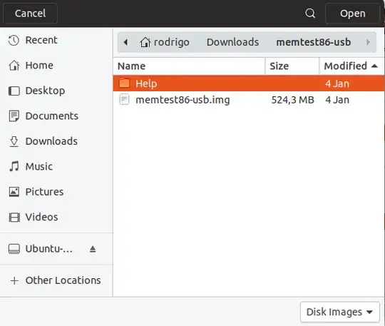

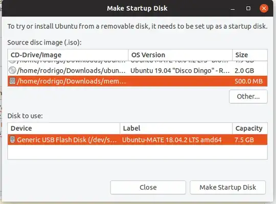

  1. Download MemTest86 from https://www.memtest86.com/download.htm
  2. Extract the zip downloaded;
  3. Open Startup Disk Creator
  4. Select memtest86-usb.img from extracted folder.
Select Disk Image type
