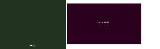

I'm remastering the ubuntu CD, I've changed some files in the isolinux folder (access.pcx, blank.pcx, gfxboot.cfg) and I have been able to change the first screen (background color to green):
But I can't change the second screen.
I made my own plymouth-theme package, and removed the plymouth-theme-ubuntu-text package. But this standard ubuntu screen is still displayed.
After installation, my own plymouth theme is well displayed.
So, I'm lost, is this screen related to plymouth? (if so, how can it be displayed after removing plymouth-theme-ubuntu-text) Or is it another file to modify?

I found my answer in backtrack linux forums. And since I set up the bounty I would like to explain a little bit what my problem was and how it got solved.
I was trying to customize Ubuntu/KUbuntu 10.04 Live CD and I couldn't figure out how to change the splash screen that shows after isolinux.
Changing playmouth theme available on the extracted filesystem.squashfs at /lib/plymouth/themes/ didn't do the trick.
So I found this message stating that the splash screen files used by the Live CD to boot reside in casper/initrd.lz.
So, if you are interested to know how to extract and reconstruct this file, read the end of the section 5.7.1. Quote:

Did you rebuild the initramfs that the liveCD uses when booting the rest of the environment to include your new plymouth theme? I suspect that is the missing step.
Kees Cook
  • 17,823
The second screenshot shows plymouth, but it is text-mode, not graphical.
You will have to make your own replacement for package plymouth-theme-ubuntu-text. The reason why text mode used is that the installer just plays safe, I guess.
This is also the plymouth that you get after installation when the installed machine has graphics drivers incapable of using kernel mode switching, so I would not suggest removing it.
