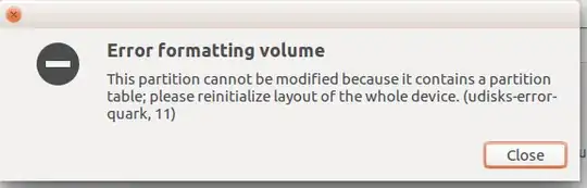

I can't format my pendrive where Ubuntu was loaded as a live USB. Whenever I do, they say:
Error formatting volume
This partition cannot be modified because it contains a partition
table; please reinitialize layout of the whole device. (udisks-error-
quark,11)
What to do? I use Disks in Ubuntu 16.04

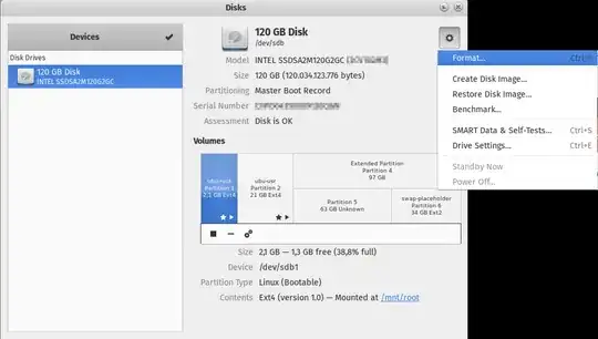

If you don't have any valuable data on that drive you can create a new partition table with Gnome Disks if it doesn't like the current one:
  1. Click on the cogwheel for drive operations and select “Format…”.

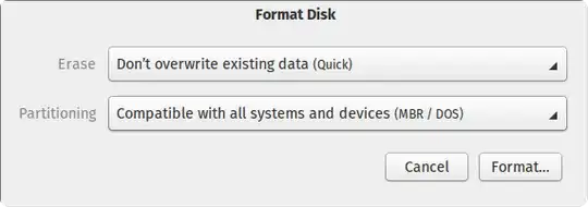

  2. Select a suitable partition table type and click on “Format…” again. For a USB flash drive you probably want “MBR/DOS” as the partition type like in the screenshot.
  3. Confirm that you want to overwrite the partition table and lose all data on the drive.

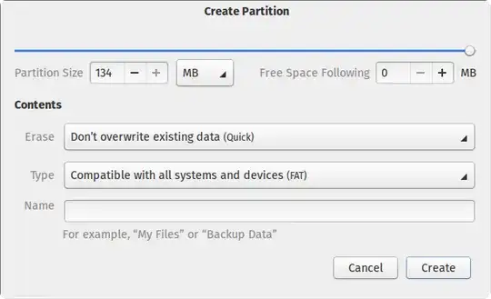

  4. Afterwards create a new partition and format it.
    1. Click on the button with the ✚ sign below the partition layout.
    2. Select
      • suitable partition boundaries (you probably want to cover the entire available space which is the default),
      • a file system (for a USB drive probably FAT, exFAT, or NTFS), and
      • optionally a name.
    3. Click on “Create”, wait a while for the file system creation to finish (can be in the range of minutes for a large but slow drive) and you’re done!

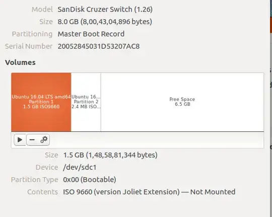

Here is what did the trick for me:
  1. Select all partitions of the USB stick and for each of them press the "Stop" button, then the "Minus" button
  2. When there is only one partition left, select it
  3. Press the "Gears" button
  4. Click "Format Partition..." and format. This times it works, somehow.

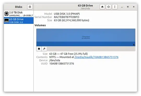

1- Open "Disks"
Disks icon
2- Find your "Device" name (/dev/sda in the image below)
Device name
3- In terminal, run ntfsfix <device_name>, for example,
ntfsfix /dev/sda
4- Now you can open your device.
