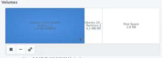

Use disks (gnome-disk-utility).
  1. On the left side, choose your USB drive.
  2. Then, on the right side you see 2 or three partitions. Select and remove them with the - button below until the stick is covered with "Free Space".
  3. Select the Free Space and press the + button below to create a new partition and format it with the preferred file system. Done.
