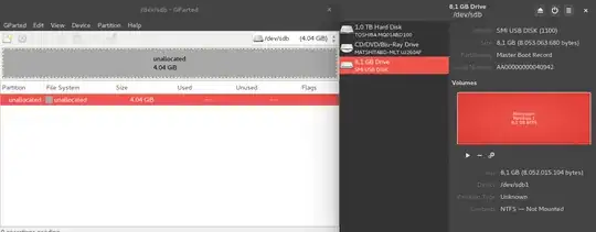

  • GParted does not recognize the whole 8GB as unallocated. I think another 4GB partition was created but I don't seem to able to manage it via GParted.
    GParted doesn't recognize whole disk

  • I tried opening the USB disk in GParted on another laptop (running Lubuntu) and there I could see the disk formatted correctly and showing up the whole 8GB. Could it the problem be my computer's system?
