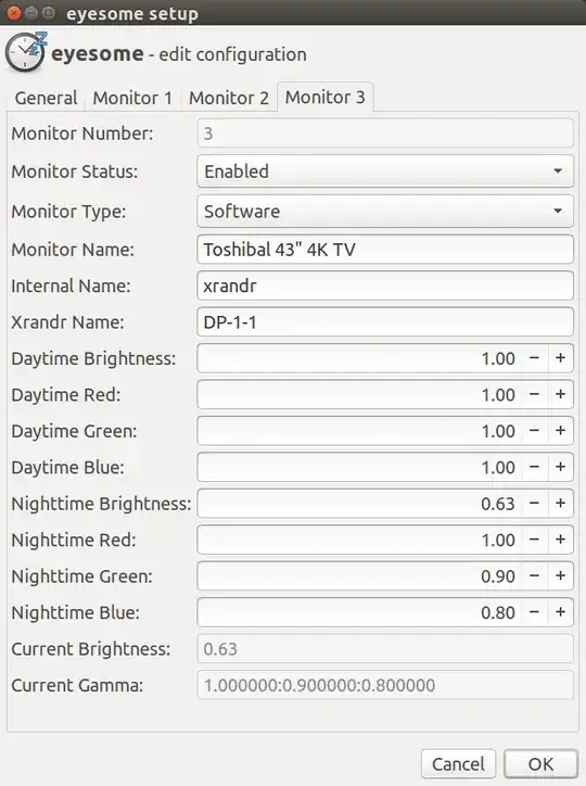

If you can't solve the problem, I wrote a bash script called eyesome that lets you control brightness and color temperature (gamma) at the same time. Additional benefits:
  • Define three monitors with different settings
  • Override two monitors (blank on inactivity) when watching movie on a third TV
  • Gradually increase in unnoticeable steps at dusk and dawn
  • In use longer than Gnome Night Light (granted not as many users)
Sample screen
