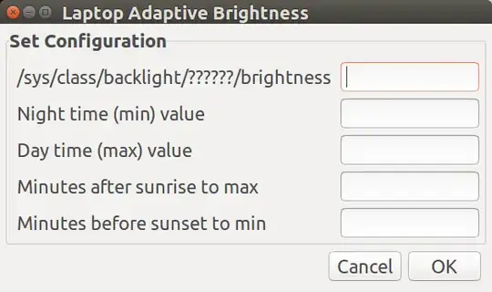

I need to setup a configuration file in Bash and believe Zenity is the best method but am having problems finding a link using google with a suitable example.
So far my code looks like this:
#!/bin/bash
zenity --forms --title="Laptop Adaptive Brightness" --text="Set Configuration" \
   --add-entry="/sys/class/backlight/??????/brightness" \
   --add-entry="Night time (min) value" \
   --add-entry="Day time (max) value" \
   --add-entry="Minutes after sunrise to max" \
   --add-entry="Minutes before sunset to min"
exit
and the resulting screen looks like this:
Adaptive Brightness Config

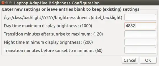

Zenity can only display previous value when there is only one entry field. As such the code below puts the previous values into the label fields and instructs user to type new value into entry fields or leave it blank to keep existing value.
The Bash Code
#!/bin/bash
# Read configuration file with entries separated by " " into array
IFS=' ' read -ra CfgArr < ~/bin/adaptive-brightness-configuration-file
# Zenity form with current values in entry label
# because initializing multiple entry data fields not supported
output=$(zenity --forms --title="Laptop Adaptive Brightness Configuration" \
        --text="Enter new settings or leave entries blank to keep (existing) settings" \
   --add-entry="/sys/class/backlight/??????/brightness driver : (${CfgArr[0]})" \
   --add-entry="Day time maximum display brightness : (${CfgArr[1]})" \
   --add-entry="Transition minutes after sunrise to maximum : (${CfgArr[2]})" \
   --add-entry="Night time minimum display brightness : (${CfgArr[3]})" \
   --add-entry="Transition minutes before sunset to minimum : (${CfgArr[4]})")
IFS='|' read -a ZenArr <<<$output # Split zenity entries separated by "|" into array elements
# Update non-blank zenity array entries into configuration array
for i in ${!ZenArr[@]}; do
    if [[ ${ZenArr[i]} != "" ]]; then CfgArr[i]=${ZenArr[i]} ; fi
done
# write configuration file using array (fields automatically separated by " ")
echo "${CfgArr[@]}" > ~/bin/adaptive-brightness-configuration-file
I was surprised after hours of googling, examples of this code couldn't be found. Hopefully others googling the same problem can find this code.
The Screen
adaptive brightness 3
In this answer the zenity form has a different order and expanded labels for fields. Although 4882 is maximum for this intel_backlight driver it's like staring into the sun and 1000 is practical maximum indoors.

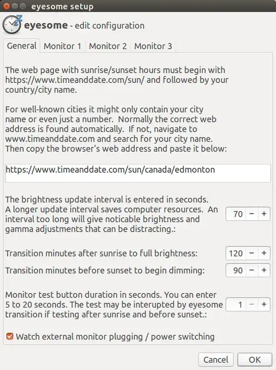

In 2018 I revamped the project and renamed it to Eyesome. Now it uses yad which is a super-charged forked version of zenity. yad uses the same coding style in bash and adds more functionality.
Notebook support for multiple tabs
Using yad you can display current field values plus create forms in tabbed notebook format:
Whilst writing this answer I noticed the screen was out of date and says 5 to 20 seconds. I've changed it to say 1 to 20 seconds for the next publication.
Monitor 3 from the tab list
Here is what Monitor 3 looks like from the tab list:
Sample code for generating this screen is listed in the next section.

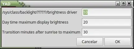

yad does the same a lot easier
$ yad --form                                                  \
   --field "/sys/class/backlight/??????/brightness driver" 10 \
   --field "Day time maximum display brightness" 20           \
   --field "Transition minutes after sunrise to maximum" 30   # And so go on
