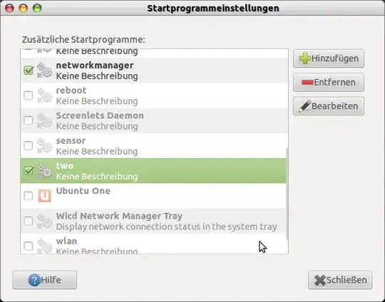

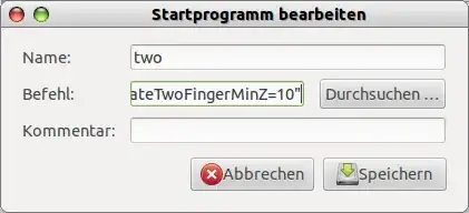

For setting the two finger tap for the middle button you can do the following.
Open start-up application start-up application
and add a new programm; command line
name it, enter in the command line the following command:
xterm -e synclient "synclient TapButton2=2"
and save it.
