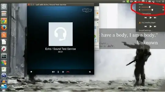

When I use skype I have 2 scrollbars for the sound:
How can I keep those 2 scrollbars all the time, and not only when I have skype conversations? When I don't talk with skype, only speaker scrollbar is visible.

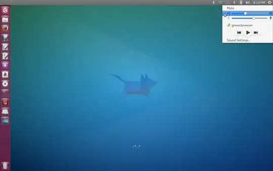

14.04
  1. Download build dependencies and source
    sudo apt-get build-dep indicator-sound
    apt-get source indicator-sound
  2. Change src/volume-control.vala
    Modify default from false to true:
    /** true when a microphone is active **/
    public bool active_mic { get; private set; default = true; }
    Comment line that sets hiding variable using //:
                case Context.SubscriptionEventType.REMOVE:
                    //this.active_mic = false;
                    break;
  3. Build and install
    cd indicator-sound-12.10.2+14.04.20140313/
    mkdir build
    cd build/
    cmake ..
    make
    sudo make install
  4. Kill running indicator-sound-service or Logout/login
    pkill -f indicator-sound-service
show mic always in sound indicator popup
Note:
For some reasons, you may want to skip sudo make install or didn't work, then just replace the executable:
sudo rm /usr/lib/x86_64-linux-gnu/indicator-sound/indicator-sound-service
sudo cp src/indicator-sound-service /usr/lib/x86_64-linux-gnu/indicator-sound/indicator-sound-service
