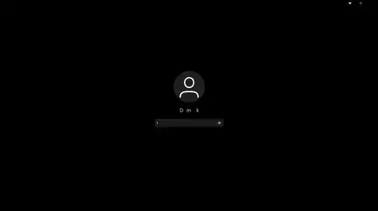

  1. Login screen login screen after resume

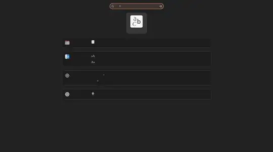

  2. App searching App searching

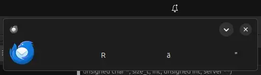

  3. Some random notification (note also the clock is missing) Notification area

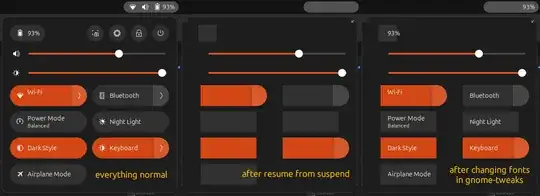

  5. It seems possible by "restoring" at least the text by changing the font in gnome-tweaks after resume, it's still not great...: enter image description here
