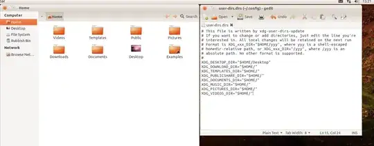

51
Aha - the definitive ~answer~ work-around, thanks to A. J. McMinn: Removing entries from Nautilus Places
  1. Comment out the unwanted bookmarks in ~/.config/user-dirs.dirs
  2. Make or edit a ~/.config/user-dirs.conf file and add the entry enabled=false.
This solution persists over boot.
*...this could be done with a one-liner: echo "enabled=false" > ~/.config/user-dirs.conf

These directories are set by xdg-user-dirs.
Reading the documentation shows that you can disable a user directory by pointing it to your home directory. Use Ubuntu-Tweak or manually edit the file ~/.conf/user-dirs.dirs and point all the bookmarks you do not want to see to your home dir, and they will also disappear from the Nautilus side bar.
NOTE: I tried commenting out and removing the lines from ~/.conf/user-dirs.dirs as forestpiskie suggests, and that worked only until the next time I logged in. By setting them to the $HOME dir, the settings stuck.
