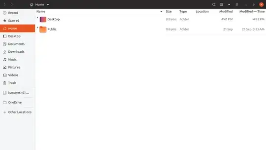

I deleted the default folders that were not required(as mentioned in question), and at next start of Ubuntu the the default folders short cuts(present on side bar) had the remove option unlocked.Example like this, in the imageenter image description here. Then I simply dragged the folders which I used frequently.
