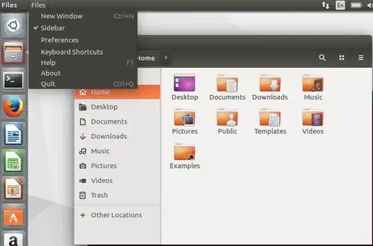

The simple way to get rid of them is to hide them. When you open files, if you move your mouse to the top bar and click "files" You can uncheck "Sidebar" and the sidebar will disappear. Sidebar Option

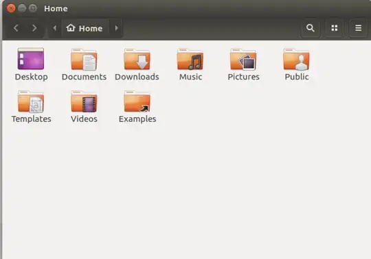

That should make it look like this. No sidebar If you want to actually remove items from the sidebar you have to edit the user-dirs.dirs file.
