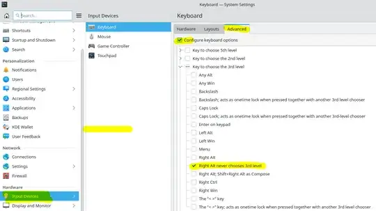

in KDE, Ubuntu it is in settings:
ACV
  • 142
