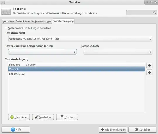

This is only a partial answer on the part 2: "How can I restore the working of AltGr key combinations to what I had before (documented above)?"
  1. Log in with an account able to do sudo.
  2. Issue the command sudo dpkg-reconfigure keyboard-configuration
  3. This will take you through simlar screens as in the initial installation on a terminal-like console. In order to navigate to the ok option use the Tab key there. Use these settings on the screens (one question per screen)
  4. Das Modell der Tatstatur dieses Rechners: Generische PC-Tastatur mit 105 Tasten (international)
  5. Herkunftsland für die Tastatur: Deutsch
  6. Tastaturbelegeung: Deutsch (the first given choice)
  7. Taste, die als AltGr funktionieren soll: Der Standard für die Tastaturbelegung
  8. Compose-Taste: keine Compose-Taste
  9. Question about Ctl-Alt-Delete: Nein
These messages were shown on the terminal:
Your console font configuration will be updated the next time your system boots. If you want to update it now, run 'setupcon' from a virtual console.
update-rc.d: warning: start and stop actions are no longer supported; falling back to defaults
insserv: script lpd: service cups already provided!
update-initramfs: deferring update (trigger activated)
Trigger für initramfs-tools (0.122ubuntu8.13) werden verarbeitet ...
update-initramfs: Generating /boot/initrd.img-4.4.0-140-generic
You have to reboot in order to make these settings effective.

From the second answer to How to enable Alt-Gr on Ubuntu 16.04? we learned to change Alternate Chacter Key in System Settings > Keyboard > Shortcuts > Typing to AltGr. I have a German keyboard and the dialogs also speak Geran. Therefore I did this:
Starting with where I started
I changed it to changed to right Alt key - keep pressed and removed englisch kbd. But that did not work for me, even after a cold start of the computer.

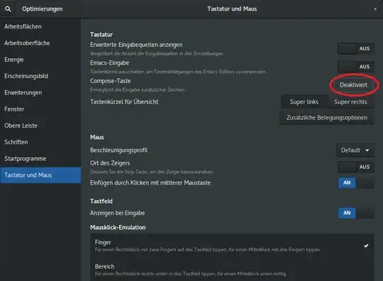

The above solutions did not work for me, but I found that there is one other setting that has the potential to interfere with the correct functioning of AltGr. In 18.04 it can be found under 'Optimierungen->Testatur und Maus->Compose-Taste', which should be set to 'Deaktiviert'. I'm not 100% certain what these are in English but perhaps 'Optimisations->Keyboard and Mouse->Compose Key' set to 'Off'.
Interestingly this setting is not changed by other methods above that involve the compose key.

Since I had a user account 'a' where the keyboard mappings for the AltGr key combinations did not work and I had the gast-account where they worked, I compared the contents of these files to their counterparts.
In doing so, I noticed that /home/a/.config/xfce4/xfconf/xfce-perchannel-xml/xfce4-keyboard-shortcuts.xml was the one which prevented user 'a' to use AltGr key combinations. There was a line
<property name="ISO_Level3_Shift" type="string" value="xfce4-screenshooter -cmw"/>
in it associating the xfce4-sceenshooter to the AltGr key. Apparently ISO_Level3_Shift is the name for that key, this name also appeared in the output of xev (as a user with that key functioning). In the other .config/xfce4/xfce4/xfconf/xfce-perchannel-xml/xfce4-keyboard-shortcuts.xml there is no reference to ISO_Level3_Shift. There also were several other deviations between the two versions of this file. Therefore I copied this file from the user which worked to user 'a' whos AltGr key combinations did not work.
However, this having done, the AltGr-Keys did not work immediately for user 'a'. I had to use the xfce4-keyboard-settings to remove a setting for “Tastenkürzel für die Belegungsänderung” (the left drop down selection box): both of these boxes have to indicate a minus sign which apparently means none.
