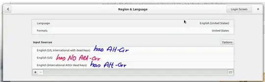

First of all (and this is the most common problem), to have AltGr working you need a keyboard layout which uses it. For example, this is my keyboard layout (Settings -> Region and Language):
Screenshot: Region & Language settings
  • English (US, international with dead keys) has AltGr.
  • English (US) has NO AltGr.
  • English (international AltGr dead keys) has AltGr.
(My preferred layout is the third one, really).
If the layout does not map AltGr+Key to anything, like for example the default "English (US)", AltGr will not work even if it's activated in the Keyboard -> Shortcuts panel.

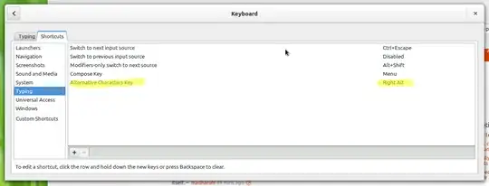

This is normally sufficient. To change the position of the AltGr you go to Settings -> Keyboard and set the "Alternative Characters Key":
Screenshot: Keyboard settings
For example, my keyboard has no physical AltGr key, so I mapped it to the Right Alt key.
Now with the third layout, pressing AltGr and n together gives ñ.
