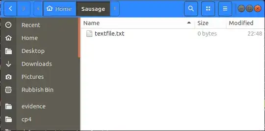

Here is how the new folder appeared before updating the configuration:

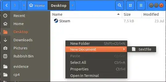

and after the restart:
and after
and the context menu in action:
