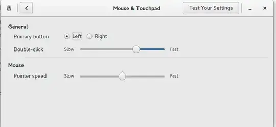

Current configuration window Current configuration window Missing touchpad configuration part Missing touchpad configuration part

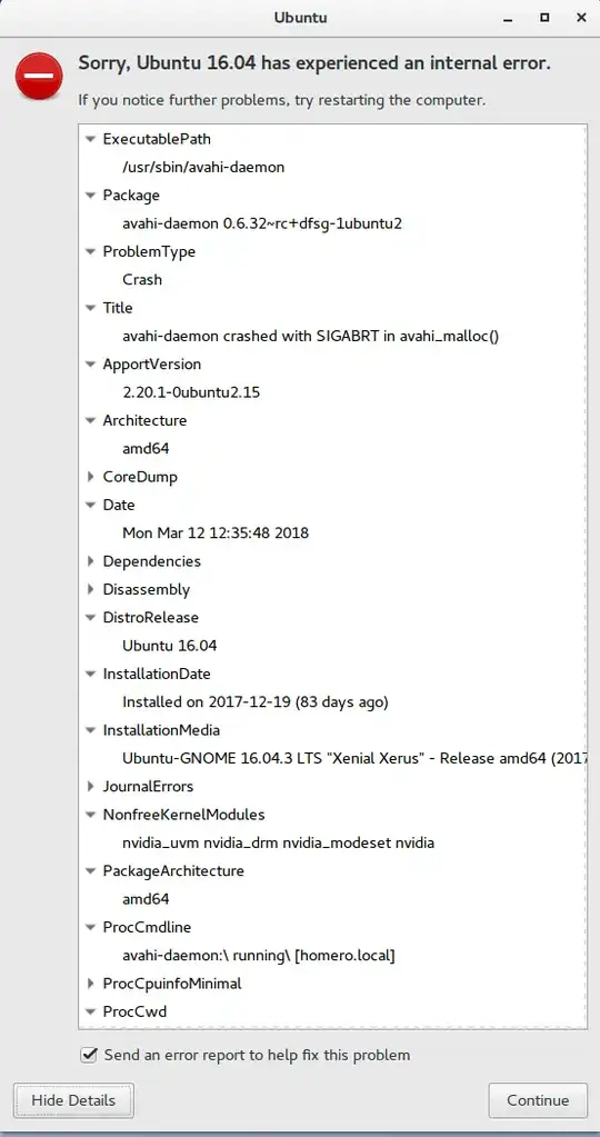

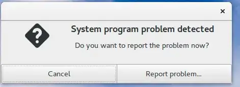

Error message Error details

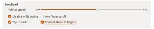

Configuration options of touchpad missing and Tap function in touchpad not working
Solution for both here: https://askubuntu.com/a/778766/315699
